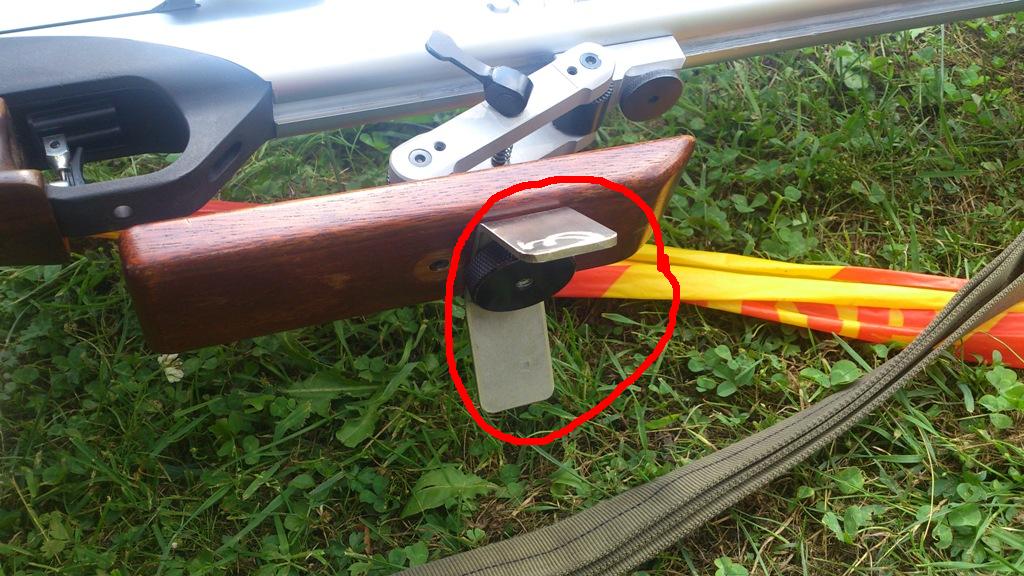

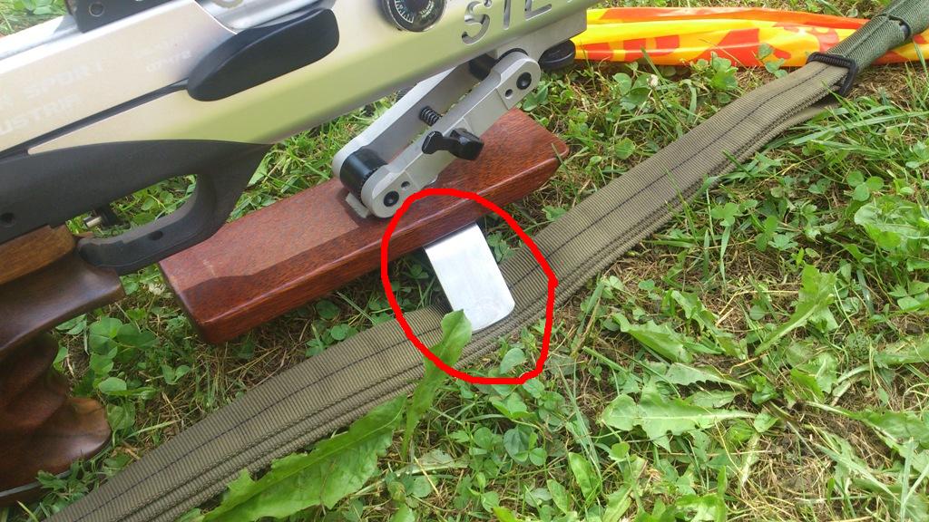

PoslaťNapísal: 12 Júl 2013, 09:35
Dnes prišla emailom otázka ohladne používania upraveného palmrestu.
Neviem či niekto má niečo podobné, ale pre istotu si to pozrite a prebehnite si aj aktualizované WFTF pravidlá (nech vás na nich nemýli minuloročný dátum, nejaké zmeny boli aj tento rok) nech je všetko O.K.
email:
otázka:
Hi dear Andy.
Please look attached photos.
I need you comment - by the official rules of FT can shooter to use devais as on a photo ( metal-plate) ?
Best regards
Stanislav Trusakov
LFTSA chairman
http://www.lftsa.lt
odpoveď:
Hi Stanislav !
My interpretation of the hamster configuration in the attached pictures, is that the hamster is of a flat design with an angular profile, which provides lateral (side) support. It is therefore not allowed under the current WFTF rules. (see excerpt from WFF rules under…)
*The surface of the hamster (and knee pad) must be flat and not shaped to provide lateral support to the rifle. (*This rule will be removed at end of championships 2013)
To all WFTF representatives :-
Please ensure that all of your countrymen and women that will be attending the 2013 World championships in Ebern are familiar with the current WFTF rules !
Mant thanks !
Andy Kays
foto:
DSC_0464.jpg [ 128.19 KiB | Zobrazené 3994 krát ]
DSC_0463.jpg [ 147.31 KiB | Zobrazené 3994 krát ]
IMG_3373 (Copy).JPG [ 154.64 KiB | Zobrazené 3994 krát ]
Rules:
